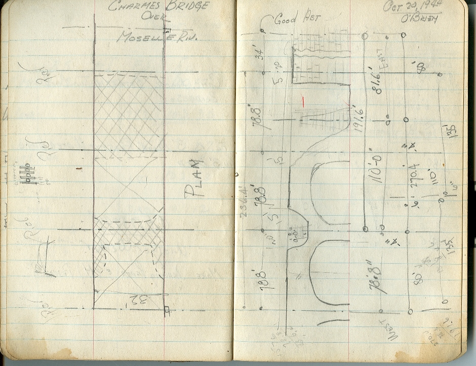

Here is a scan from my Grandfather’s notebook (one of several he had.) This page is from Oct 20, 1944 and is a sketch from the plan for the Charmes Bridge over the Moselle. I looked up "Charmes Bridge" on Google and found this. As the regiment in question passed over the bridge more than a month before I don't think they were the same but I it was all I could find.
I've got more pages from his notebook that I will add periodically. As they need to be of a fairly large size to appreciate, I can't have a lot of them on at the same time.

From the OFFICIAL - Basic - Daily Journal Report, Oct 44. Hqs 2d BN., 540th Engr. Regt.
20 October 1944: Company "D", Chatenois, France. Building ramps between hospital buildings for moving patients from one building to other buildings at 21st General Hospital, Mirecourt, France. Operating water point and showers. Hauling lumber for hospital job in Mirecourt. Company "E", Mirecourt, France. Provide and put in operation utilities in buildings of 21st General Hospital in Mirecourt, France/ Building#!, checked and repaired water lines to toilets. Complete except for heating and hot water. 95% complete. Building#3, same as Building #1. 95% complete. Building #5, complete except for heating and hot water. 95% complete. Building #7, continued installation of fuse and switch boards. 95% complete. Building #9, continued installation of master fuse and switchboard. 95% complete. Building #11, continued installation of master fuse and switchboard. 95% complete. Building #4, complete except for heating and hot water. 95% complete. Building #6, continued repairing tile flooring. 40% complete. Building#8, laid small sections of tile floor. 35% complete. Building #10, continued installation of plumbing fixtures. 85% complete. Building #12, continued installation of electrical fixtures. Continued repairing plumbing. 95% complete. Central heating plant: checked and refilled boilers. continued small fires for drying out boilers. Administration: Worked on basement drainage. Utilities section: continued work on water lines. 60 % complete. Tunnel: Worked on repair of water line. 35% complete. Company "F", Darney, France. Completed laying cable at 21st General Hospital, Mirecourt, France. Completed digging road across road at hospital. Hauled 50 telephone poles and erected 11. 20 % complete. Hauling gravel for truck turn-about at railhead. Made two (2) truck crossings at railroad tracks. 35% complete. Hauling gravel for Regimental HQ. 30% complete. Started constructing platform and pouring concrete at 21st General Hospital in Mirecourt. 20% complete.

BRIDGE ASSIGNMENTS:
Work completed on two canal bridges, Highway N 57 vic Epinal and two canal bridges on N 57 vic Crevechamps and Flavigny; completed construction of 290' double-single, 1-way, Class 24 Bailey Bridge vic Charmes; reinforcement of Bailey bridge construction (Pont D'Ain) completed; dismanted 150' Bailey bridge, Chatel, and hauled to dump area; moutning water head and current conditions due to heavy rains during period involved the Regiment in an extensive bridge reconnaissance, maintenance, repair and reconstruction program, principally vic Nomexy, Chatel, and Charmes; completed replacement of 1-way bridge vic Chatel with 2-way Class 40 fixed construction (336'6" long X 24' wide); two bridges removed; German bridge and Bailey bridge across Moselle River vic Chatel.

18-21 October 1944
Mirecourt, France:
Canal bridge at Nomexy on approach road to main highway bridge across the Moselle River at Chatel was washed out and replaced. The center bent of the Chatel bridge washed out and work started to replace it with a pile bent. On the next day , however, the adjacent trestle bent washed out and it was decided to widen and reinforce the entire bridge to a two-way, Class 40. The was done by replacing the washed-out trestle bents with double-pile bents and adding three piles and the necessary additional stringers and flooring to each of the existing 16 trestle bents that remained. Road system, RR cross-overs, and unloading area was established in the railhead at Hymont. Work continued on construction of two-way, Class 40 fixed bridge across the Moselle at Charmes until high water washed out the reinforced one-way bridge. It was decided to provide a crossings of the Moselle at Charmes by the construction, instead of a one-way, Class 24 Bailey bridge at the site of the partially demolished highway bridge.
Daily Journal
20 October, 1944:
Co "A" - Epinal, France - Construction of a 2way Cl. 40 1way Cl. 70 Bridge at Charmes was discontinued per VOCO. Materials were hauled from Charmes to Bridge site at Chatel.
Co "B" - Bayon, France - 33 - Road maintenacne: Removed mud and improved drainage on Route N-404 from Route N-57 to Route N-419. Hauled and spread 15 loads of gravel on road net of gas dump in Charmes. Hauled and spread 6 loads of gravel on road net near Bayon. Preparation of site for 51st Evac Hosp. Constructed and installed 1 culvert. Hauled and spread 78 loads of gravel on road net. Hauled material to 1st Bn Dump. Maintenance of Moselle River Bridge at Bayon. - Revetted fill. Hauled and spread 5 loads of gravel on approaches. Maintained 24 hour traffic control.
Co "C" - Igney, France: - 88 - Reconstruct Canal Bridge at Nomexy - Completed 1 trestle. Secured and placed in position 24 stell I beams. Placed 6" X 6" wooden stringers. Laid 40' of deckings. Project 45% complete. 89- Repair of Bridge over Moselle River at Chatel. - Constructed 2-9 1/2" caps. Cut 4 piling to size for caps. At 0340 hours the original bent slipped 7 inches and flooring and guard rails has to be ripped up. Project 20% complete.
